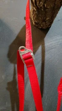

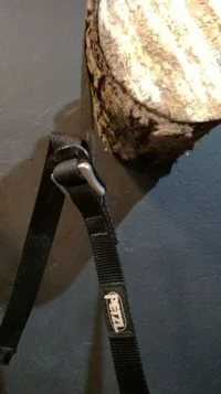

Magnum 783, the Torse is similar to the Secur but not the same. Everyone that I have talked to that has used both liked the Torse better. Chances are that if yours was rubbing on your neck, the rear buckle was probably set too high.
What is the difference I can't see any. I agree I may have had my secur set at little askew might have to give it a go one day soon. I just really like the simplicity of the HUT.
What is the difference I can't see any....
Honestly I'm not sure as I have not used the Secur. I suspect that aside from the narrower and stiffer webbing that the buckle is different. Maybe you could take a close look at the picture and let us know. The Torse buckle adjusts tighter with just a pull on the tail and lengthens by lifting up on the tab that has the small hole. By the way that hole is where I clip the Haas carabiner.

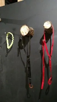

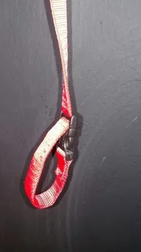

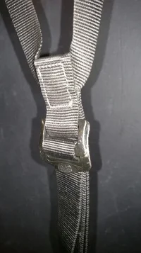

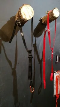

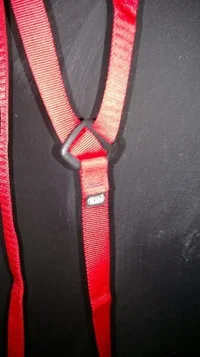

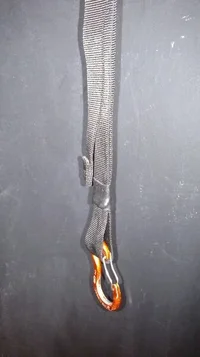

Secur vs Torse
