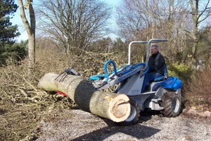

That sounds like a great set up. I hope it continues to work out for you. I was also looking at the 3 pt hitch option. It would make the unit more versatile and add some counterweight for those bigger loads.

here is a picture from their website of the gt50. It is about $40,000 and gives the swinger 2000 some competition. I like the smaller ones but never know when you need the extra lifting power.
