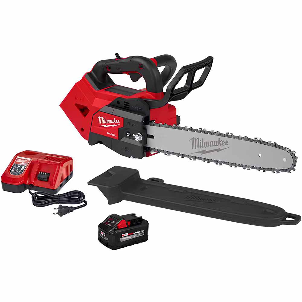

not from me. I haven't used the husky. I've used the stihl msa 161T a good amount and the Milwaukee buries it. I don't know if that's a fair comparison though because the 161T feels like it was designed for pruning. The Milwaukee feels like its designed to get whatever the bar fits into done. If I did mostly pruning, I would seriously look at a lighter saw. If I were doing a mix or pruning and removals, the Milwaukee might stand out because I can always put a lighter battery in it if need be. The advertised weight on the Milwaukee with the 14" bar is 8.2lbs without battery. 10.8 lbs with.

"...this chainsaw operates at around 15 meters per second (that’s around 49 feet per second). That’s not as fast as many gas-powered top handle chainsaws—which is where most of the complaining comes from online (we know who you are!) What Milwaukee does, however—like most battery-powered saws we’ve seen and used—is drop the speed and give you torque. That means you don’t really see the chain speed drop very much as you go through the cut. It’s very confident."
FWIW:
Makita XCU08 claims chain speed of 3940 feet per minute. That translates into 65.7 feet per second.
Husqvarna T540i XP (battery saw) is 78.7 FPS
Husqvarna T540 XP II (gas) is 63.6 FPS
A quick search didn't turn up chain speed for a 201T...or torque specifications for any of those
I've assumed, based on use, that Makita gave up torque for chain speed. This Milwaukee better have some serious torque to give up that much speed.
New Makita 40v is supposed to do like 80 fps.
Milwaukee - on an 18V system - has slow chain speeds, acceptable torque, narrow kerf chains, and long battery usage. No surprise there.

10.8#s is ms261 (50cc saw) weight range. Yikes!
Yep and the 2511 is 5#s or a little over. Don’t get me wrong I’m all about hitting the button for instant go time with the battery saws. They just aren’t there yet for power to weight. And @Phil I appreciate the review on the Milwaukee.
I feel like Milwaukee could really nail the power to weight with a direct competitor to the 2511t. The 18V system is a tad small and thus more suited for smaller tools like a reduction pruning saw. Milwaukee is always making better technology to squeeze more from 18V. Reduction pruning saws are just a small market, though, and it seems like most companies feel like they have to tackle the ms201t to get respect. Having said that, Echo did not tackle the ms201t - they went after the ms151t and look at their success. Husqvarna went head to head with the 201t and did very well. I feel like Husky is going to clearly beat out this iteration of the Milwaukee tophandle. For me, I'm still wanting to buy Milwaukee tools - chainsaws included - because the Superhawg has a clutch. Talk about a single-issue voter, lol. I'm happy with whatever tophandle they put out because it's better than none, but I'd be happiest with a 2511t competitor. Just waiting to retire my 2511t when I don't have to pull a chord while finessing my 200 pounds in small wood... This Milwaukee saw doesn't look like it will retire my 2511t.

I'd like the top handle but seems too heavy compared to 2511t. I'm hoping they make a smaller version before I buy the 2500t.
That for the link to the review @Phil had some decent info....but not a great reviewer. Spent too much time on Chainsaw 101 stuff like chain tension, how an oiler works, and chain catch. Too much time with RPM calculations - just tell me the numbers match up to the book. Also, he's gonna end up with some face scars... holding the chain brake back while running the saw isn't a good plan...neither is starting a plunge cut with the top corner of the bar. But he does show the power of the saw, so that was good!
At the end he covers kits and pricing...I'm a little nervous about what I'm getting now. Acme Tool says the 2826-21T includes both batteries...that's what I bought (and why I bought it). He said that was the 2826-22T kit containing both.
