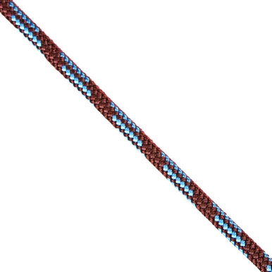

Right thats what i was thinking aswell. My other lanyard i use a distel and triple attachment pulley to use it as a climber as i work my way up switching from actual climber to lanyard. Ok ill be testing out icetail and tennex to make a hip prusik for my 2 in 1. But will have other cords soon if they dont end up working. Thanks. Oh yeah where did you end up getting your bulk ultra tech anyway.? Was it wes spur or somewhere else. I definitely want some after the way you talk about it.
Treestuff has it.
Armour prus is really smooth, bailout is nice, beeline is good, ocean poly is good. RIT is too slick/ stiff IMO, never could get reliable grabbing out of that cord.
