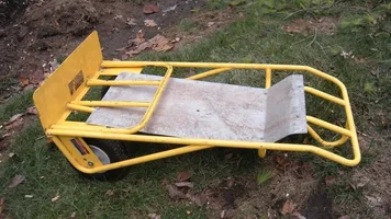

Dudes, inside secret. Harbor Freight, its called a bale cart, about a hundred bucks. Mod it with screen grate or aluminum like what is shown here.
It does tip over.

I got a hand truck from harbor freight that has been good to me. It is blue with shields over the tires. Maybe $40 on sale. Not as good for bigger stuff as that bale cart, from the looks of it, but it is fairly compact and light.
I use the blade like a lever near the center of gravity, at an angle to the log. I pivot the log so that it is in line with the hand truck, with the slightly heavier end toward the handle. I can balance the log and pull or push it around. I was able to move a green redwood log that as about 9" avg diameter by 12' feet or so (maybe a bit larger on both measuremnts) easily by myself. I've also move heavier logs with some help.
A little extension on the corners of the blade would allow easier large round carrying, and allow a log to be cradled when moving logs laid perpendicular to the axle.
Here's one I made a few years ago. I started with the exact dolly that southsound is talking about, cut off the blade, covered it in 1" thick oak, added two front urethane caster swivel wheels, an additional back axel & wheels and a ratchet strap tie-down (not shown).
