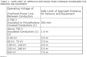

An employer shall ensure that no worker approaches and that no equipment is operated, and no worker shall approach or operate equipment, within 7 meters of a live overhead power line unless
a) The worker is, or the operation is directed by, a competent utility employee with the meaning of the Electrical Utility Regulations (Alta. Reg. 44/76), or
b) At least the following clearances, as set out in the following table, are maintained between the worker or the equipment and the overhead power line conductors:

Kevin from that table it says to keep 300mm away, about 12". Aound here if you are certifed we just can't touch it. We have put many clean and dry ropes over the service drops to pull them out of the way.
