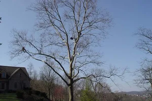

Long limb walks are always fun..............that is me on the left...........look hard!!!
