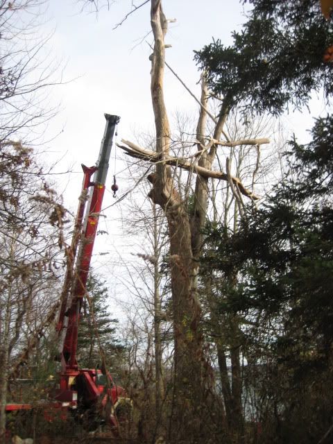

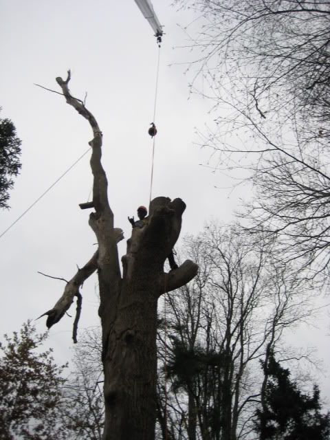

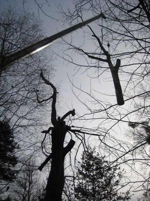

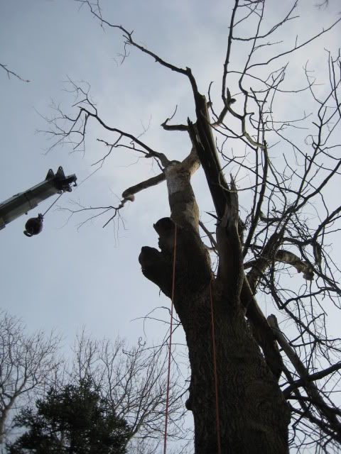

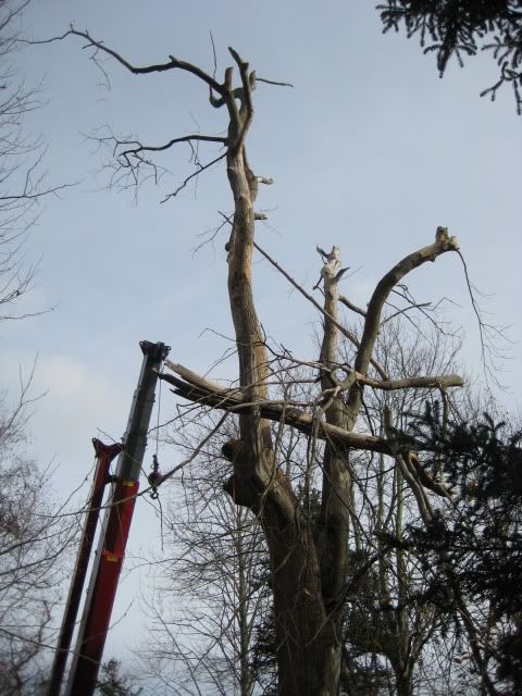

This may have been the scariest removal I have climbed on. 75 ft Tulip tree struck by lightening, after which Bartlett cabled it (One of the most hacked cable jobs I've ever seen).Broken cabled pieces hanging off it in a rats nest. Stood dead for maybe a year. This thing had stress cracks all up and down it, I was waiting to lose a piece breaking off the picks (real windy right on the water), but thankfully it never happened. Everything went slick as sh!t.
^That's me being an idiot....
Didn't have the cutter with us that day, I had to unwrap em and let the pieces drop, tried the hacksaw first, but, damn, that cable is strong.

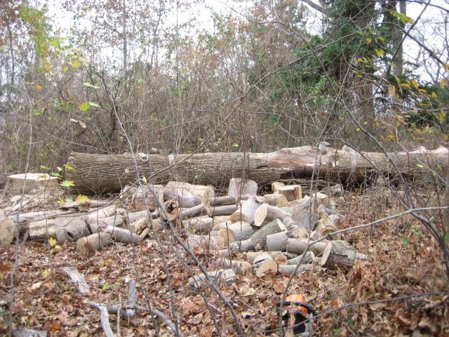

Nice work! Glad everything went "slick as shiat"! Was the log still solid? I've always wanted to mill a log that has a lightning strike through it but haven't run across a good candidate yet. Maybe one day I'll get lucky.
Actually I was suprised at how solid it was (what a relief), and to tell you the truth, we just split it up as firewood. But the grain was pretty impressive in my book. Lots of purple and yellow, very psychadelic

Did you uncover and sound the roots? I always do that with dead or dying trees. Falling with one tree is excusable but two would mean I'd have to seek another line of work.
I never count on it but I've found that killer lightning strikes tend to make wedge shaped decay columns that stay fairly narrow, so the trunk doesn't lose TOO much strength.
Thanks Blinky.
By "sound the roots" do you mean check them for decay, etc.? If so, I did not, but should have, now that you mention it
. And yes you are right, it did seem the "column" of decay definitely narrowed toward the base.I was surprised at how sound the wood was after cutting below the main crotch split. Good points, and well put. Thanks again.
