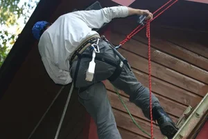

I really don't like ladders; so when I have to use them, I try to safety up.
Last summer I painted our house, a trilevel which means some of it is pretty high if not protected (I remember MasterBlaster's "if it's over 10 feet it's hazardous, if it's under 10 feet it's dangerous). So anytime I got above step ladder height I roped in.

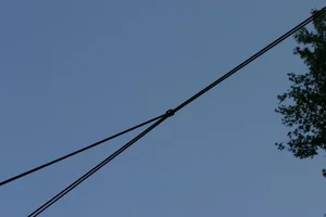

I climbed a big poplar in the front yard to about 50 feet high, took my bow and shot a blunt tipped arrow (a .38 cartridge case on the shaft) with small nylon cord across the house into the backyard. Then I was able to string a 2 rope skyline across the highest part of the house (2nd rope was backup). (I had the spare rope nicely coiled and hung on a limb...had several treemen come by to see if I needed help with any trees..that rope was like a bait).
Whenever I was on the side of the house not directly under the skyline, I would run a climbing rope out to where I needed protection and the TIP on the skyline would slide along to where I needed it via the "two biners, alternate/opposing gates" a la Tom's note.

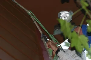

I also used a fall arrester (pictured) on a vertical/horizontal rope I rigged on the side of the house. This helped hold me (with "tensegrity", Tom) at some of the areas that were hard to get to.
