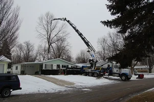

Once you have run a boom with 3 KNUCKLES & so many extensions, unlimited boom angle issues, every other crane seems like a step down (maybe just to me.) I do realy like AT cranes. But the authorities here would not let me drive one of those job to job, & definately not out of town like i often go.
mike, cool picture.
i've noticed your lift axles down in past pictures too.
my thought is to keep it up, because the lift axle will always add air pressure to try and keep the same pounds on the lift axle tires; and when the outriggers take off weight, the lift axles might try to extend really far and the other tires can't do this.
I've tried it both ways. I did think at one time, it was good to have as many tires down as I could, but then decided against it, because the other tires don't have a lot of weight on them, but the lift axle will always try to keep the same weight load on them, as when they are running down the road.
i've never asked anyone about this.
i'm not confident on what is best. your thoughts?
any truck driver tell ya they only get used to help with load weight. Does the boom add weight to the bed of the truck while picking? If not then they not doing a darn thing.
