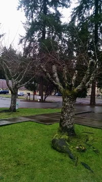

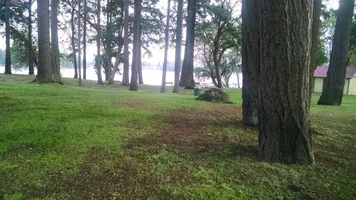

This is what I'm working with in some areas. Little turf growth. Other areas, its full-on lawn.
BTW, I know that RCX is part 1.
Nice 'pruning', huh? About 100 of those.

Roundup CAN damage trees through lenticels and thin bark; less issues with trees like you show.
re sheet mulching, Depends on type of grass--rhizomatous sp. (wiry-rooted) will often persist or even thrive under mulch.
As long as it doesn't break through.
These are thick barked doug-fir, and cherries chock full o' lenticels.
