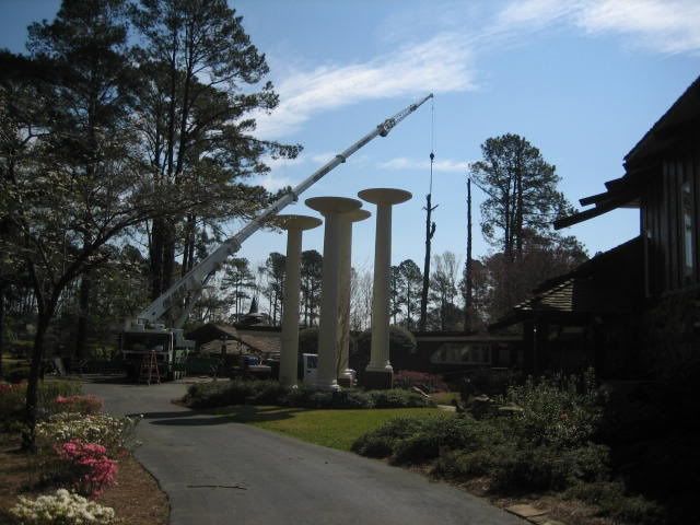

Jib going on since I took it of cause we never use it
It sure did seem to wiggle a bit more. Had more trouble with getting the crane level in that driveway. The load kept pulling to the front of the truck. I was constantly on the swing break all day. Talk about riding the break gave new meaning on that job!
