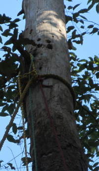

I spotted a stub on the dead tree about forty feet up, and managed to get a throw line over it. Then I pulled two light ropes over the stub. I put a thimble on the end of each rope and ran my big pulling rope through the thimbles and around the tree in a choker arrangement. I positioned the thimbles on opposite sides of the tree, and pulled the choker up close to the stub. Getting the pulling rope in a good position was easier than I thought it would be.

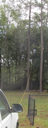

I ran the pulling rope to my truck in the neighbor's back yard.
I cut the notch, backed the truck to add tension, made the back cut, and backed the truck some more. The top of the tree fell off as the tree started to fall, and the tree broke just below the pulling rope on the way down. As the upper part fell, it broke a branch of the nearby oak.

I'm - as per usual - having trouble visualizing the choking configuration. Why could you not use the stub to run your pulling line up and around, add a running bowline, and choke the stem that way?
I just looked at a picture of a running bowline. That's what I used. Thanks.
I was surprised how easy it was to get it to slide up the lower part of the tree that was covered with bark. A little jostling of the ropes was all it took.

So you formed the choking loop (running bowline) around the stem at ground level, then hoisted it up to near the stub using the thimbles *prior* to tightening it around the stem? I think I get it, possibly.
A doubled-through the RB throwline will allow you hold-back tension, then be slipped out of the RB when the RB is seated. Also, if things snag up prematurely, or the stub breaks, etc, you can retrieve and reset.
A second rope will work, too.
a running bowline with a bight will allow this to be done with one long rope, also.
