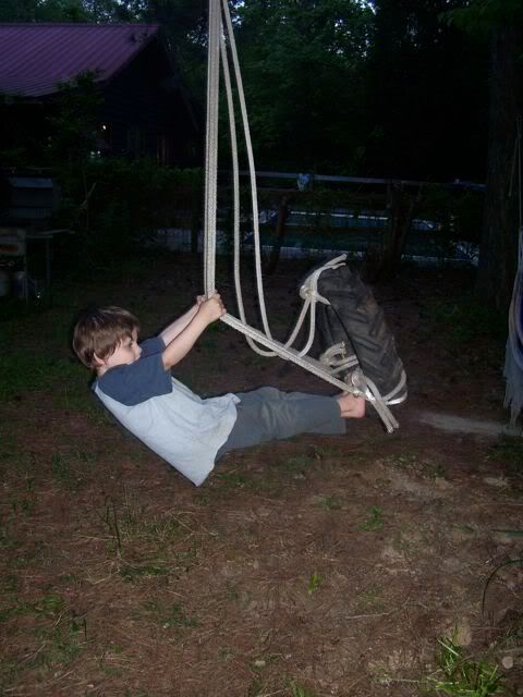

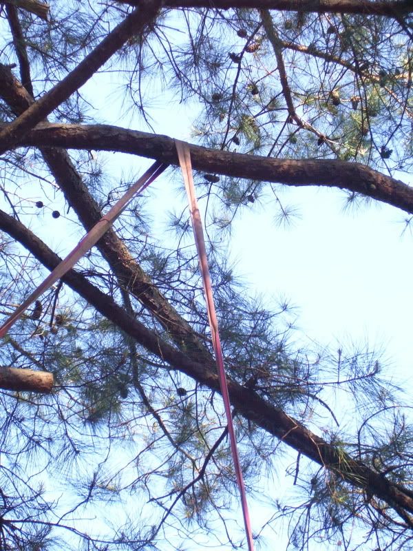

Not a pro but this worked for this tire swing. I have it anchored around the stem.
