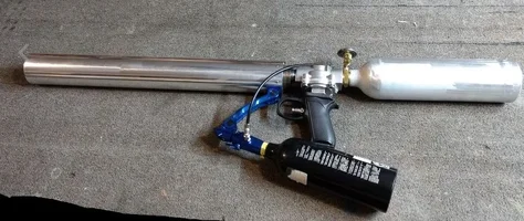

I also have contacted JJ sporting in the past, that's where I first saw the idea to drill out the neck of a paintball tank. Frank has a lot of experience in taking the potato gun/tshirt cannon thing into a decent side business. I bought one of his trigger buttons on eBay a while back for $7, thinking it would be an improvement over a Harbor Freight blowgun. But it did not have nearly enough flow to trigger a basic sprinkler valve (lots of honking not much launching), which I imagine is why he has to drill them out to get a decent CV and then sells the "better" version for $30. I like his cannons and he pays himself appropriately for the work, they sell for >$300 though and his "not plastic" valves are still not metal (fiber reinforced composite). Apparently he had them custom made 100 at a time for a price of $70 each. Not sure if he'd sell you one for that same price. If anyone builds one out, I'd be curious to compare its performance next to a standard sprinkler valve. The QEVs that I am promoting have three distinct advantages over the sprinkler style:
1) cast alloy 2) larger 1-1/2" opening yields better performance and no adapters for the barrel 3) they have their own trigger exhaust, which dramatically improves performance and trigger response.
I have a photo from JJ of a couple more of their cannons, attached here for the curious.
Update, I called JJ Paintball today to inquire, and not only was Frank Casto happy to share the information with me, he also mentioned that he has built the exact cannon we are all seeking, for the United States Forest Service for measuring Sequoia's. You can find him on Facebook at Frank Casto or JJ Paintball. I have no affiliation, I am just stoked to hopefully have solved this problem permanently. As even he said we dont need polished aluminum barrels, get the can and trigger assembly from him and add your own barrel. I still am not sure how much it will run me but when I get the invoice Ill let y'all know. He also was more than willing to sell the parts, but when you realize that 350 in parts sells for 400? For me it was an easy decision.

Sinthome has lots of great ideas and valid points. If you have the equipment to drill, ream, and tap, aluminum cylinders are perfect- we add a fill nipple, a gauge, and a safety pop off.

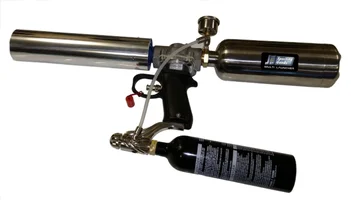

Ahh, I knew you sounded familiar- no wonder you have great ideas! Thanks for the mention! I have newer toys for you to try now! Anyhow, I do sell the common $7.99 trigger trigger buttons like seen on E-Bay and Palmer's ect, and I freely show the mods you can do them. But the $22 performance buttons are a special design we have made, - plus I drill em out some more! The $30 button isn't the usual 1/8" it is a fully vented 1/4", comes with a safety cap, and is amazing. My newest, $70 custom made valve IS aluminum, and designed for air- and it blows sprinkler valves out of the water. The 80 cubic inch, polished, stainless steel, ultralight air chambers are professionally built, hydrotested, and certified for USA, Canada, and Europe. So far, TreeBuzz members have TWO bag launchers with the new valve/trigger combo.

That looks pretty cool. How much does that rig in the last pic cost? How many shots per tank? I'm assuming that's a paintball tank?
I have a 120lb compressor at the house, I fill my 20 dollar 5 gal portable harbor freight air tank to about 100psi (best she can do) Then I can shoot a 16oz bag 100' straight up about 6 times all on one tank.
Hope that helps, I am sure you can use co2 and it works as well or better
