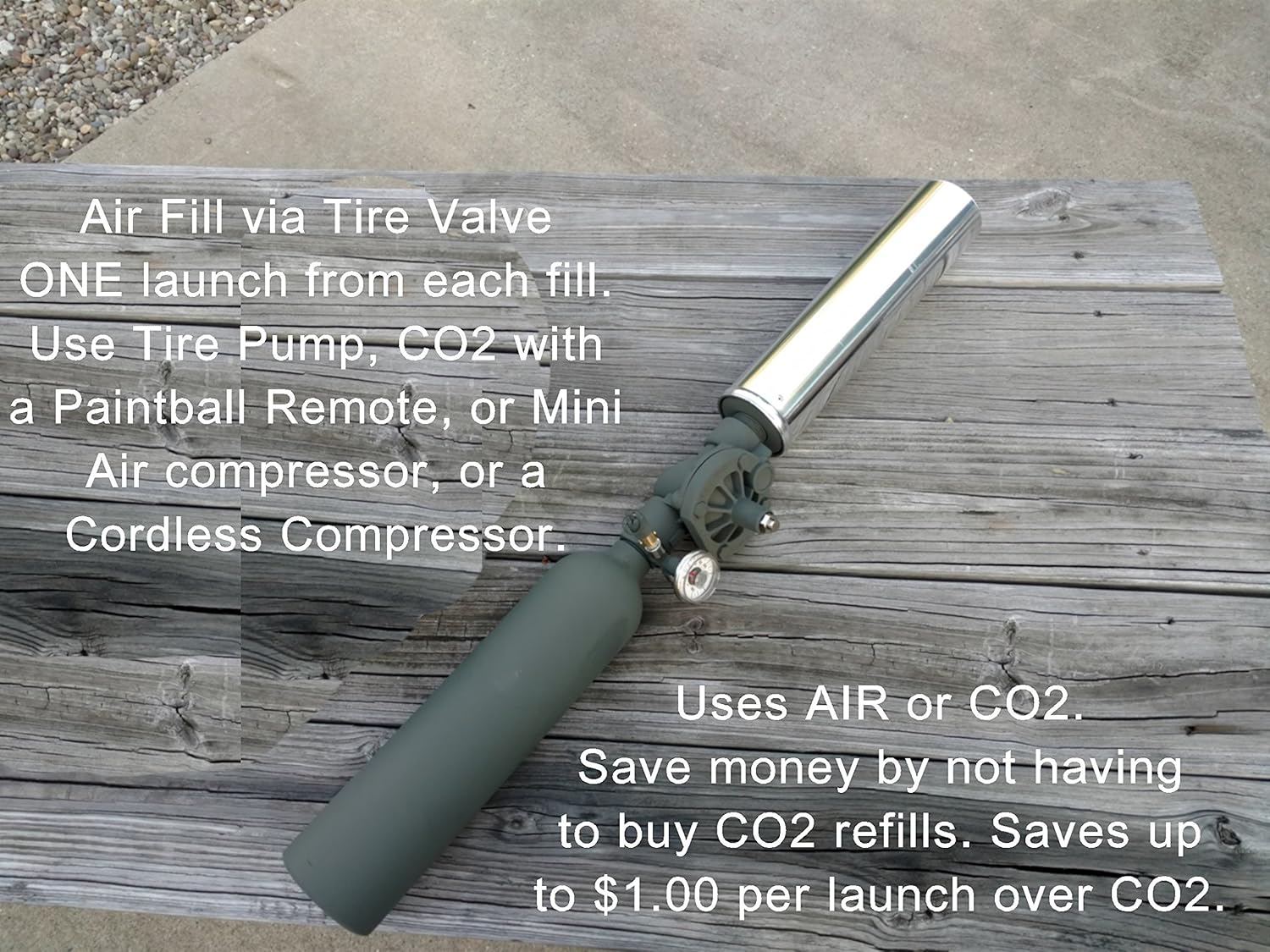

Personally, love the idea and have been at it myself as well as I could see spending 200 for a APTA even if they were in stock. That being said, it looks like the folks at J&J sporting goods in Marietta Ohio have it figured out
Update, I called JJ Paintball today to inquire, and not only was Frank Casto happy to share the information with me, he also mentioned that he has built the exact cannon we are all seeking, for the United States Forest Service for measuring Sequoia's. You can find him on Facebook at Frank Casto or JJ Paintball. I have no affiliation, I am just stoked to hopefully have solved this problem permanently. As even he said we dont need polished aluminum barrels, get the can and trigger assembly from him and add your own barrel. I still am not sure how much it will run me but when I get the invoice Ill let y'all know. He also was more than willing to sell the parts, but when you realize that 350 in parts sells for 400? For me it was an easy decision.
I have found the 12g CO2 for
$.40 a piece to use with my APTA.
I still like this however. Thank You.
