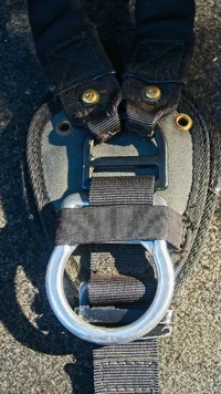

Because the Ergo is modular, you have options for waist belt and bridge. Pictured is the waist best needed for the fall arrest. I use the croll quite a bit. Here it is pictured separate from the saddle. With this set up to meet ANSI requirements the carabiner must be one of the 16kN gate type. The same is true for any carabiner in a fall arrest system.
As for previous comments that suggested that any of the Buckingham harness do not meet ANSI Standards is B.S. I can't speak to CE standards, but see no reason they would not.

Do you find there is enough room for srt with the ascender that low on the harness?
Not sure what you mean. The Croll? I rarely use it as part of an SRT asent system. As for other positions on the harness, typically the lower you can have an ascender (within reason) the more upright the climber the more efficient. The extra loop at the waist is nice as it frees up the bridge and is closer to my waist.
Tony
I don’t really find myself using it much but I don’t use SRT for work positioning often, just canopy access and descent.
