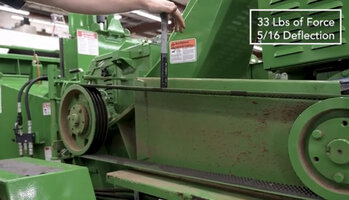

Ok, so wanted to just give an update on the auto feed issue…Bandit guys said they are very confident it’s a belt tension issue and that all I need to do is tighten the belt…I hope they are right! I’m going to do that tomorrow, I know the specs (I guess) are 33lb of force with 5/16’s deflection. But I measured it today and they were arguably set correctly with those tolerances.
So what should I do? Make it tighter than bandit says? I don’t really want to leave it and watch it completely stall out the chipper when I put something big in!
I figure I’ll make it tighter than their specs, but could that cause other problems? Looking for input on chipper belt troubleshooting…overall

Keep in mind, that is 33 pounds PER BELT and you probably have a four-vee belt, which means 122 pounds of force on the whole belt to hit your deflection number. That belt should be really tight!
Belt dressing may help too, as will a light touch with emery paper to break up the glaze that probably came about from the belt slipping while it was too loose.
It’s 1 big belt that fits into pulleys with 4 groves…
Here’s a screen shot from a demonstration video of adjusting a bandit 12xp belt

That’s what I thought was on there, it’s actually four belts attached together to make one - you can run four individual belts instead, but the one big belt can’t flap against itself and flapping between belts makes heat and heat kills belts.

Well it tightened the belt even tighter than I think bandit specs call for, but auto feed sometime doesn’t kick in and work, sometimes (must with bigger wood). Only happened once today, but I should have it at all in my opinion. Maybe I should take that glass of the pulley that you mentioned reach? I wonder if that would be enough?
