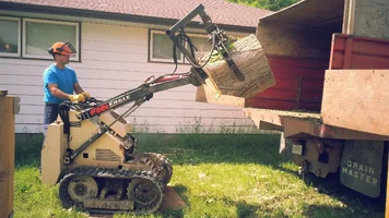

Introducing FrankenFinn. Converted to tracks and diesel. I bought it like this. It is a good light mini. Can pick up 500ish lbs. probably due to the extra weight of the undercarriage. The original wheeled version will be lighter. But for the price point it is not a bad starter unit. But it is slow for long hauls.
That's awesome I have the same machine and thought about doing this. could you post more pictures of how the center part was built.
