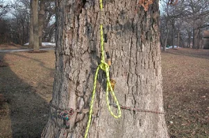

help me check my SRT work positioning system
Actually, there is no hitch climber, a have just a prussic and no micro pulley at all. just biner, beeline prussic, tenex tether to figure eight. top biner is clipped to poison ivy climbing line. Unless I am at the very top of the tree when I get hurt, the biner will not have to pass through any crotches.
Treebing, I know the porty and prussik look like a bit of an overkill and I actually believe that to be true with the Unicender. However, it is a carryover for when I was setting a floating false crotch for my doubled rope system.
My ground crew (wife) really likes the port-a-wrap. We have practiced with this and she has a lot of confidence in its abilities. It is a small port-a-wrap and I have never had a problem with it pulling the unweighted line except for when I am recrotching. But that is why I added the prussik so that if it did fall from slack that nothing would be amiss and it would still hold when the slack was taken up.

looks overly complicated for the anchor. Should use a longer rope for the single line and that will simplify greatly. Also, why are you using a prusik in combination with a fig. 8? Super redundant.
