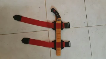

I primarily do removals in hardwoods. And if I'm climbing I prefer the saw on my leg, in the bucket truck i clip it to my bucket for easy access.

I considered sharpening the saw, but with the scabbord wearing out, I figured I'd get another saw altogether. The top is worn out enough that the saw bottoms out in the scabbord and hooks the bottom with the tip of the blade. Sometimes it's a two handed operation just to remove my saw.
