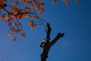

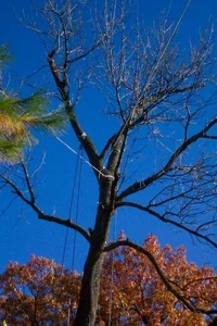

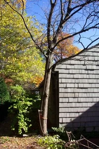

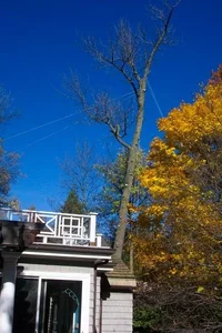

This was an ash tree removal we did last week. Fortunately for us it leaned away from the house. There was a smaller 2 stemmed (18"/15")mulberry beneath the lean that we were able to lift out using the GCRS. The ash had approx. 10% lean, so we opted to guy it back ("V" rig) to 2 trees. There were also some minor trunk defects approx. 45' up. You can see the climbers line to the right. He is in the Mulberry.

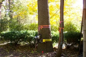

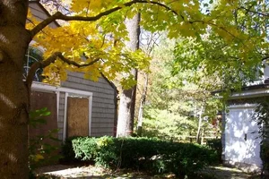

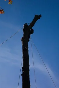

This is the 2nd guy line. It is horizontal at the right and goes thru the branch union on the left to a port-a-wrap. We used a prusik and a 1,500 lb. come-a-long to tighten up the guy lines.
