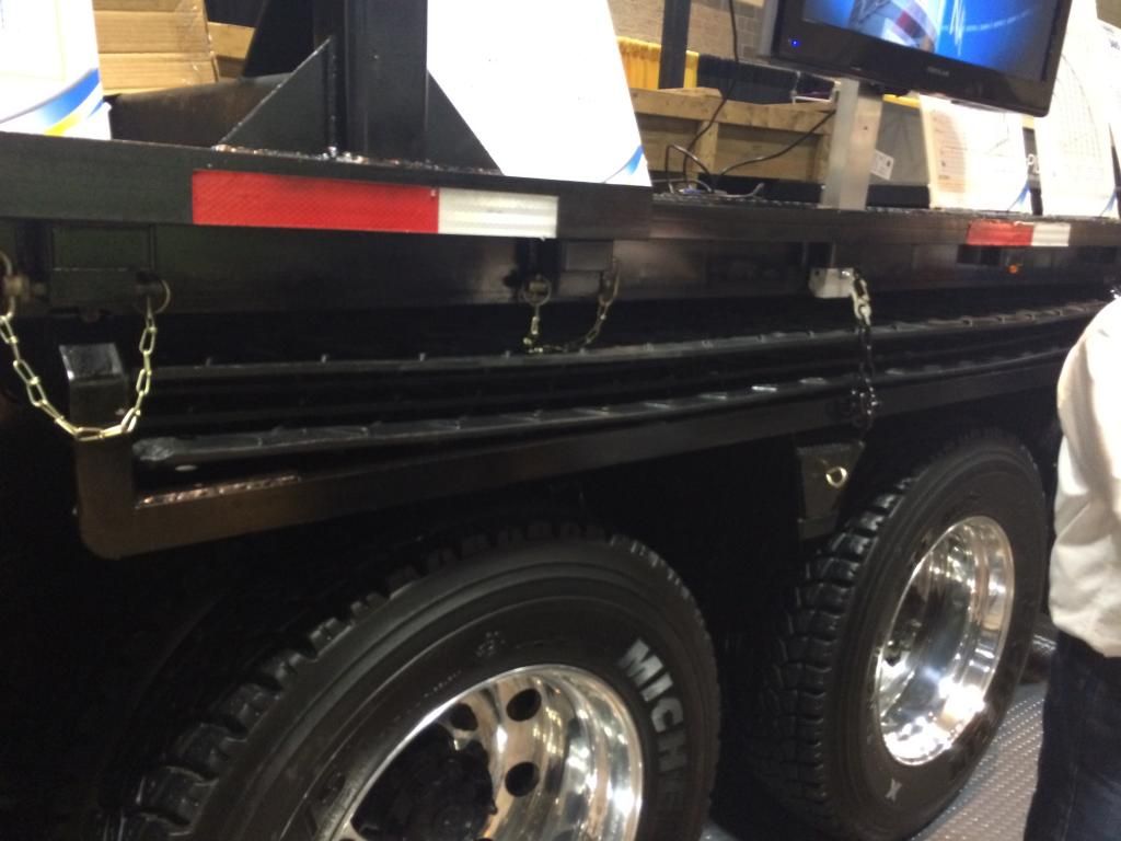

I ordered all the steel for the new body this morning it is going to be delivered Wednesday if you guys would like ill post pic along and along of the build. I ended up ordering some 9 lb pf. Jr ibeam and 4x4x1/4 tubing for the sub base. I'm going to use one 8x24x1/4 solid T1 steel plate for the floor to get me started.
Will do!!! The steel will be here wednesday I'll start posting some pic then and in the meantime if you guys have any Ida or suggestions please post them Thanks guys

J.m.o. But 1/4 sides is way overkill. The weight alone would be prohibitive. Best dump I've churned out was 11ga. mild steel sheet over 3" .180 wall square tube frame. It was built for and Had the shit beat out of it by a horde of no-minds for 3years now with no problems. Just my quick estimate one 20'x6' side made of 1/4 would weight approx 80% of what a whole box made of 11ga. Hell of a lot of fuel to waste.
