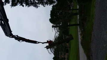

If it's a sparse conifer, it'll work great. If it's really thick, getting the grapple in to grab the trunk can be difficult and sometimes impossible. The great thing about the tree-mek is its versatility. You have options. You can still do it the old fashioned way with the basket. On my facebook I have many pictures of pine removals and removals of spars with just the hook.
This picture is of scotch pine removals.

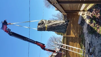

In most removals, I can get enough off of the tree to just drop what's left. In this case I climbed up my ladder and put some slings on to lift it out.

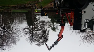

These pines were growing in a line along a busy road. They were sparse enough for me to use the Mecanil SG220 to remove everything down to about 20'-25'. At this point I just grab the top of the spar and cut it off at the ground.

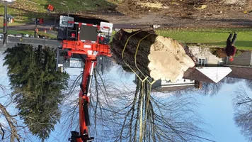

This picture is a big tree for me. I do many like this. Bob Montgomery (tree-mek #2) in Cleveland does freaking monster trees! Cleveland has some massive trees. You should talk to him sometime. He doesn't really do much social media though.
