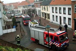

It was a 50mm PE pipe i struck and penetrated. Unfortunately the manager from the shop called the police and firedepartment. (small pipe low pressure, no sweat for the maintanance crews to fix) That will cost some bucks, two firetrucks, two command cars, two police cars and a evacuation planned for the arounding buildings....

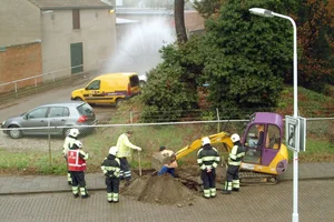

that yellow car is the company car, got it just last week...
renault kangoo 4wd, would be a shame to got it fried if the gas had ignited

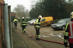

the fireman put up some hoses for sure and at the end they had a waterscreen to dispurse the gas, it was collecting in a roofed corner from the shop.

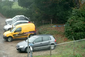

digging up the gaspipe near the street to drill a hole in, pop a inflatable ballon in, pressurize it and the leak stops for repair.

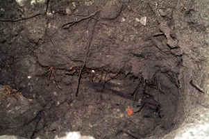

Here you see the dugged hole at the street. At 80cm deep under the pavement you see these fine roots. At that depth there was old topsoil/humus what indicated to me that in the past this area was filled in higher with soil. Roots were healty and soil was sandy with some rubble in. Not much compacted although there was a street above. At the leak itself also good soil and much fine roots trough the whole top 60cm of soil. For the repair only a few 3-5 roots ø 4-5 cm were teared out. (i cut them with my silky, need a new)
