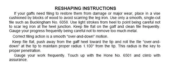

During sharpening, it's extremely important to keep the bevel on the last quarter inch of the gaff. One should sharpen the underside of the gaff only.
Check out the link below for instructions:
http://www.kleintools.com/instructions/pdf/139184_Gaff_Instructions.pdf
The 'plane test' is true for all gaffs. I start with a flat file and finish with a stone. I like my gaffs very sharp.
