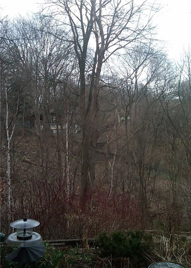

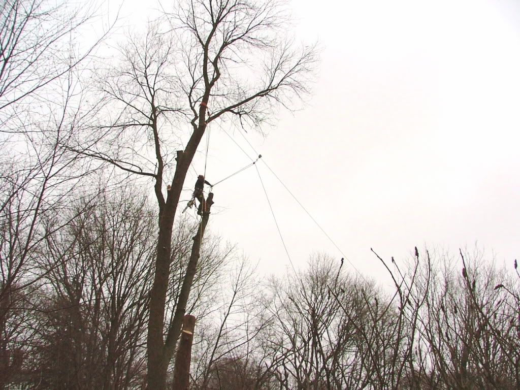

Here's the first pic taken. It was on the second day when we finally got our act together to take photos. Of course it became overcast and made the pics pretty dark. Hope this is not too big!

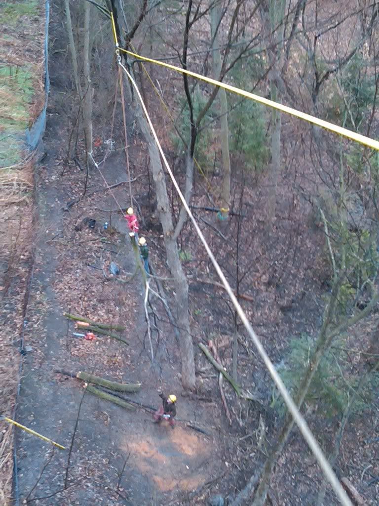

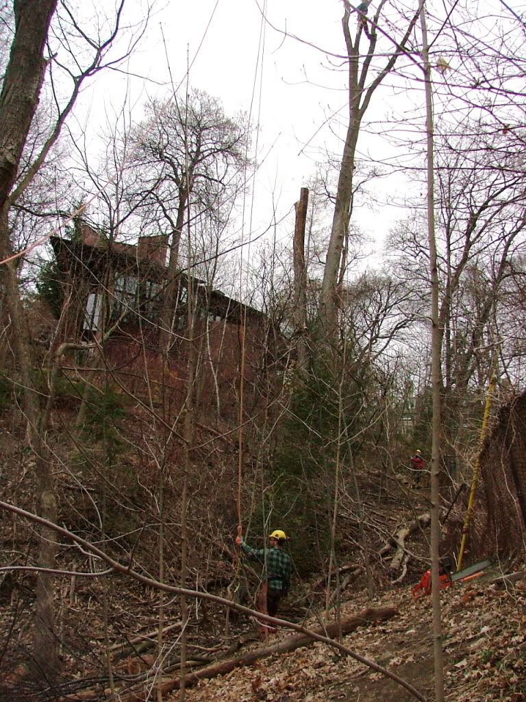

This is the drop zone with Mark "The Mule" getting the lines ready to send back up to me. Marlin's just uphill to his right running the lowering/haulback line through the porti.
This slope was once dominated by Acer platanoides and negundos with no understory. Concrete, brick, cinders and old waste was scattered over the site. Over 12 years the site has been transformed into a mixed native ravine slope that showcases how these properties can be recovered and rejuvenated. Though this Elm isn't native it was left to provide some shade until DED got it.

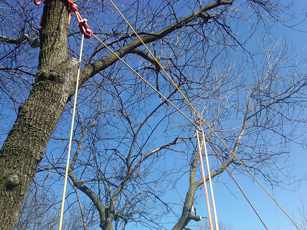

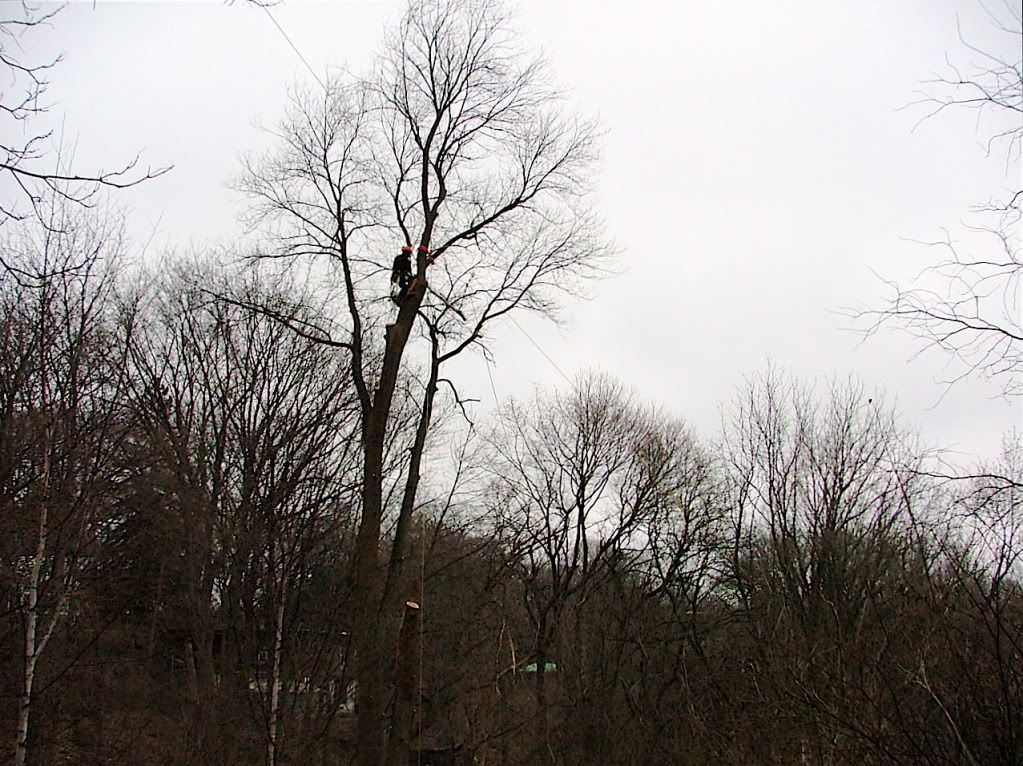

Here's a couple of pieces on their way down to the drop zone. By setting up the control and haulback lines in opposition through the s/s 2x pulley the line held the piece up while at the same time moving it down the traverse in a controlled manner.

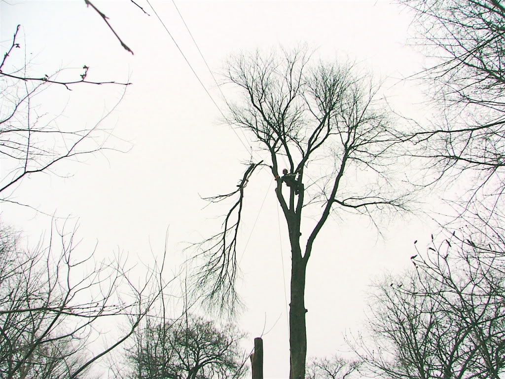

We're sending the final piece of the co-dom's crown down the line. Really important for us not to lower the piece too soon or we'd be entangled with the saplings below. The crew really worked well together.

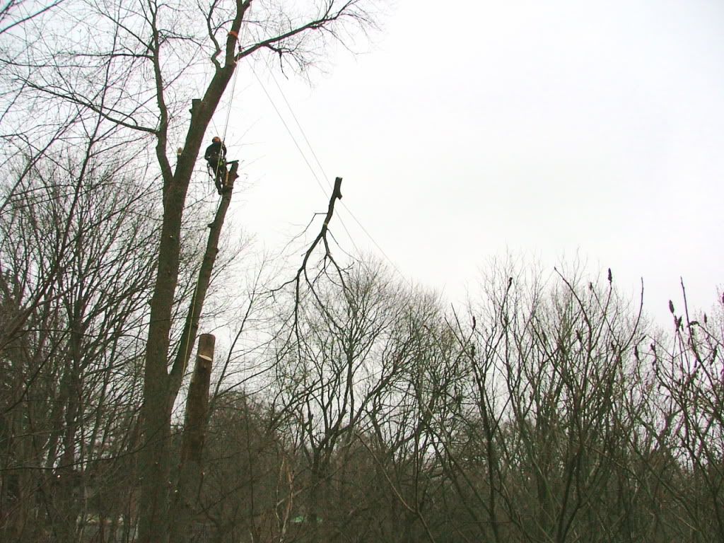

Ok, a very short clip of a piece of the co'dom trunk traversing. Sorry about the quality, it's a first time with a digital SLR. Low res and the rain didn't help with exposure!
