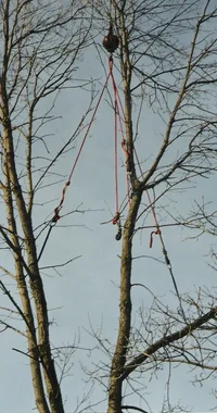

I was at a rigging supplier's shop one day and bought the four leg spider. It's made from 3/4 Tenex and only cost about $30. Each end had a loopie splice for adjustment. I took the splice out to make the legs longer. The adjusters are made from Tenex. On one end there's a long eye so that I can tie a klemheist, the other has a small eye to clip a biner.
There are webbing slings choked onto the tree, clipped to a biner, clipped to the white adjuster.

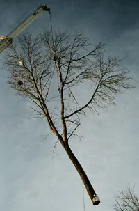

There were six ash trees in a restaurant courtyard to be removed. Six cuts, put the butt into the chipper and go home with a load of chips. There was a nice trailer load of firewood too. Very little back muscle used on this job.
