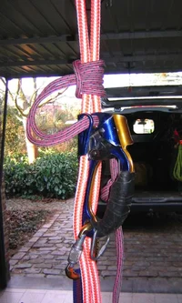

Any dual handled twin ascender out there has one too many handles. One hand goes on the ascender, the other on the rope below it. The second handle is useless. We're not doing frickin pull-ups with these tools.
Blinky and I are using very much the same setup, and though we are not conspiring in any way, we came into this completely independent of one another, but our general approach and outlook on footlocking is quite similar; it's easier than many make it out to be. My feeling is that we have a unique advantage in having single handled, paired ascenders, without which no one can experience footlocking quite like we can.
The reason we have them is because the industry manufacturers have not created them yet, so a very few arborists on the planet have gone ahead and created them for themselves. Here is a picture that came out of Belgium, with an interesting and effective backup.
