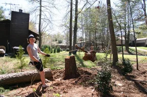

That leaner I recently took down generated some pretty good chunks. They yard was recently landscaped so I can't get a truck back to the cut site. A wheel barrow or just rollling them sounds like too much hard labor. We rigged a zip line, hoisted the chunks up high and walked them out to the curb. I have a 600 pound rope hoist that I would have used but this is the first weekend in years that somebody borrowed it to lift an attic staircase (solo job for him). We rigged the hoist with pulleys...wish I'd had 2 more for the bigger chunks.
Anybody have pictures of a similar system you have used? Any info on how much drop is needed to work best?
The pictures are posted at:
http://layton.smugmug.com/Tree%20Job%203-30-05

That's a great idea...some of the heavy chunks really robbed the rig of elevation. I could have gin poled to get it back.
It did save a lot of straining and wrestling with big chunks.

A dolly is a good idea, might have worked if I laid down a bed of plywood to roll it on...the only dollies I have are for warehouse/office moving of equipment, the wheels would bog down in the dirt (maybe they make balloon tired dollies for this type work?)
Three factors were really at work...
1. the landscaping was brand new and I didn't want to mess up the yard (mine!).
2. To me the chunks were big...it's all relative...some of you pro guys do this all the time...it is sporadic for me. I learned this work in the 70's (manila ropes and all) and did it as I went through college. 200-300 pounds is a lot of wood to me when I can't get my truck near it.
3. I wanted the practice of rigging a load bearing zip line. We did roll some of them to the road (about 90 feet) through my neighbors yard but floated/zipped most of them. It was a great excuse to use a lot of gear, try to keep the skills up and learn a little.
