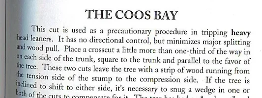

Is there a problem with "kerfing" or cutting into the hinge before back cutting or triggering the back strap. In Mr. Beranek's book "The Fundamentals of General Tree Work" , on page 309, there's a method referred to as The Coo's Bay. It says this is for head leaners only to help prevent barbers chair. I have always considered myself an average faller with decent skills enough to keep myself and others from getting killed. I'm quite familiar with the back strap technique and use it often. Now to the point...Last week, while working on a steep wooded hillside with tall hardwoods to be flopped for vista clearance of a new subdivision, I had a very close call with a barber chair incident! 85 foot, 18 inch diameter,slight forward lean. The species was a Shagbark Hickory. Strong, strong, wood. It was towards the end of the day and I guess I was complacent and ready to go home. Anyway, because of the Highline in the direction of lean, I thought I would "cheat" the direction slightly and be on my way. I was wrong and like Graeme said earlier this was a perfect candidate where it was easier for the trunk to split up the sides than to break the hinge. I consider myself lucky. I knew the inherent dangers and should have taken a second look. I'm

The coos bay is non directional and I would opt for the side notching technique for better control.

For directional felling on heavy leaners i use a notch(scarf) to about 1/4 of the diameter of the tree. i then cut at 90degrees to the hinge as per the coos bay. this leaves me with a reduced area of wood that to cut hence avoiding a barbers chair as the cut can be completed much quicker
Pete;
I admit to never using the coos bay but that's contrary to what GF says about it as far as being directional.
