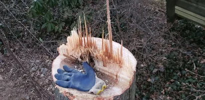

While the guidelines are ok for beginners:
"notches are to be 1/3 the diameter deep (or 80% of the width of the trunk)"
"Hinges are to be 10% the trunk width"
"back cuts are to be 1-2" higher than the floor of the notch"
There are a lot of reasons to transcend these "rules"
This oak hinge is over 25% thick and taking advantage of the full width of the trunk to keep as much fiber as possible lengthwise.
The size of those whiskers shows that the hinge had a LOT of control and stayed intact until the face closed.
What are the detriments of such a fat and side hinge?
Would @Tony condone or teach the use of such a fat hinge?

While you can get a feel for what you can and can't do with different tree species,
what is promoted above dramatically increases the risk of barber chair.
that is the answer I was thinking of as the main concern with this hinge. The trunk was wrapped 6-8x with a short piece of 5/8" line, then a trucker's strap was cinched on top of the line to keep the trunk from splitting.
"Trancending rules, truckers straps, trunk wrapped 6-8 x, whiskers, and fat hinge".
I myself can't wait to hear the epic, nonsensical storyline that will undoubtedly be spun concerning this 12"-14" DBH backyard monster....
Seems odd that the fibres are standing dead straight, the stumps I’ve seen with large fibre pull are normally bent in the direction of fall
