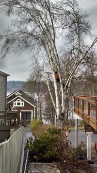

Tyler up there working with yIMG_20190307_111035853_HDR.webpou? If so tell him I have a HH2 for him...
He said he wants more spurless climbing, on damp snow-damaged birch, with a Hydra's head.
8 Doug-fir cleanings yesterday had too much traction, even with epiphytes.

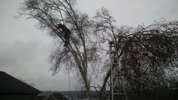

Damn that’s a tall freakin ladder
I was up near the top of that 16' orchard ladder, head over the top, for sure, on the second story deck, looking down at concrete, sloping down and away. I'm not a bull in a China shop, luckily. One branch broke onto the other, tangling them, so I pieced them out, while he worked other stuff. No great TIPs on that tree.
