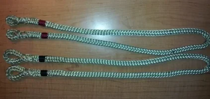

when i'm lockstitching this splice:
1) should i try to go in between strands, or is it ok to just stitch through the middle?
2) on locking brummel, where to begin stitch? where exactly is the throat - below the locks, or just below the eye?
3) can i perform only a whiplock instead of stitch? do both? the stitching alone seems pretty easy to pull out
4) what is a blind stitch?
thanks,
will
2) Stitch right where the bury begins. Anywhere else and it is possible to just pull the bury out.
