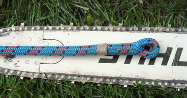

So heres the first one. I felt it came out pretty nice. Its still really stiff behind the eye, the strands are really expanded, seems as though some of the "pro" splices I've gotten from Sherrill/Shelter have a "looser" feeling to them, but dont know whats the norm persay.
This one I followed to instructions, and it says to mark the core at point "D" and point "B" using the NE Ropes splice guide, and then to taper, cut at a 45* about halfway between the two marks, which to me essentially leaves you with just that 3-4" bury of core entirely.
I finished another one in short order Saturday afternoon, and I left the core tail a little longer, and didnt cut the strands off at as steep of an angle. The rope doesnt have as smooth of a taper behind the eye as my first one, and wonder if thats related to the extra inch or so of core, along with having less steep of a taper on the core tail. I got a much better understanding of the splice with completion of my 3rd one. I'm now starting to be able to somewhat visualize the order of things as far as whats going on inside the rope, whereas before I was pretty dumbfounded as to how there was core inside cover, and cover inside core, and how the heck it all made sense!
I already hung off the splice, and took a few 2 foot drops to shock load it a bit. Didnt budge so much as a hair! Very promising. :)

And another.......
I did a weakass lock stitch on it, in addition to the whipping, which I now realize after hammering the needle through with the twine.........nothing is going anywhere. Even tried bending it apart unloaded to see if I could work the bury out, again didnt move.

And another... Even tried bending it apart unloaded to see if I could work the bury out, again didnt move.
Nice looking work, Jeff! And I'm really glad you tried the bending experiment (before stitching, I hope?) to see if the bury would work out. If it holds up to that, it is truly bomber. A hollow-braid splice is much more vulnerable.
