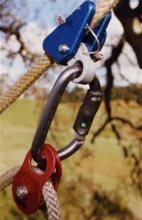

I salute Roger Phillips. I had a feeling this might have been done before as its a natural train of thought to add mechanical advantage. The main differences are the gear used and the fine tunings, additions and subtractions.
I'll leave it to stumper and treebing to work out the ratio's as maths gives me a thumping head. I do however have another idea I'm playing with so I'll hopefully be back with something soon.
Suggestions on what to start with. One picture at a time? Yes their are many different scenarios. Start simple and move up the line of evolution? Try this attachment and let me know if it comes through?

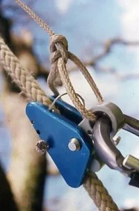

One way that I use to advance the micro pulley system is to use the lever arm of my pole pruners. I don't even have to disconect my pruners from my saddle attachment point. The longer the pole the further the extension. Yes the throw-line works for the initial climb but when working up and down elsewhere the pruner comes in handy.Of course many folks don't use a pole pruner and I respect that decision but when it gets to getting around in a tree sometimes the pole pruner is an essential part of climbing. My opinion for when and where it is worth.

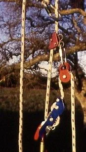

This is a single line technique that also works on helping to get up a tree. I use a stop at the base and also attach a throw line to the microascender to help advance the pulley up the line.

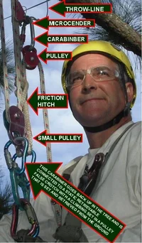

This might help some of you that may have realized the importance of the purchase of equipment that produce results , reduce fatique and are well worth the initial investment. Not everything is right for everybody it is up to each individual to make the choice to change.

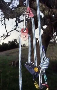

It all starts with a stir-up hitch. Learned it from a Davey manual from the thirties. How to perform an aerial rescue on a pole rescue. Climb above the injuried climber and put in a false crotch stir-up hitch. Lower yourself down to the climber. Maybe put two in to help lower the climber also.Options keep them open!More pic's to follow.
Number three in sequence of eight total pics.
Enjoy, for goodness sake I sure did and still do enjoy using them each day I climb.

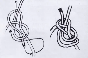

The knot I use to form the loop for the removable false crotch.
Number four.
Remember when you form the loop with the Yosemite bowline to make sure that the loop portion that hangs down is large enough to allow for the pulley to pass back through. You can also use this hitch for a redirect line . More on that later. Some one remind me!
