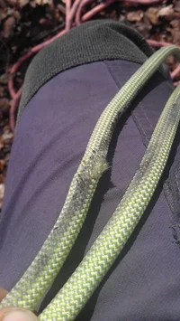

Therefore I have tried Apus from edelrid as a footlock prusik http://shop.freeworker.de/seile/klemmknotenseile/edelrid-apus.html
But after only two climbing days the mantle was burned through :-(
Anyone with a better option?
