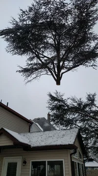

Double sling pick.

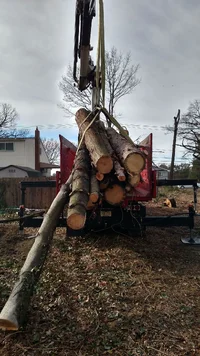

I'm also interested in capacity and efficiency using the kbooms to haul logs? Is it feasible to say for most decent size remove jobs you can do without the log truck. Back to royces point, with the labor pool shrinking how can more be done with less.....
We have a 16ft dump body on our 65 metric ton Kboom. IMG_20170111_104426875_HDR.webp IMG_20170315_132513607.webp
A truck like mine doesn't have much weight capacity left the way it's set up. If I switched out the lift axle out to a 20,000# axle I could get much more and then yes I could do away with the log truck for logs or brush. I have made a chip top for mine when I had a big chipping job that worked out also. It all deeeepends on what your local area/state dot requirements are.
I use to do straight through cuts on almost every pick until i did a shelf cut good. Now i only do shelf cuts and cradle cuts, they keep the piece stationary until the climber is clear and allow the op and climber to adjust the lift pressure when you make the top cut on the shelf cut so the piece is perfectly set and ready for the pick.15035687_681757955334457_1610306951508393984_n.webp
