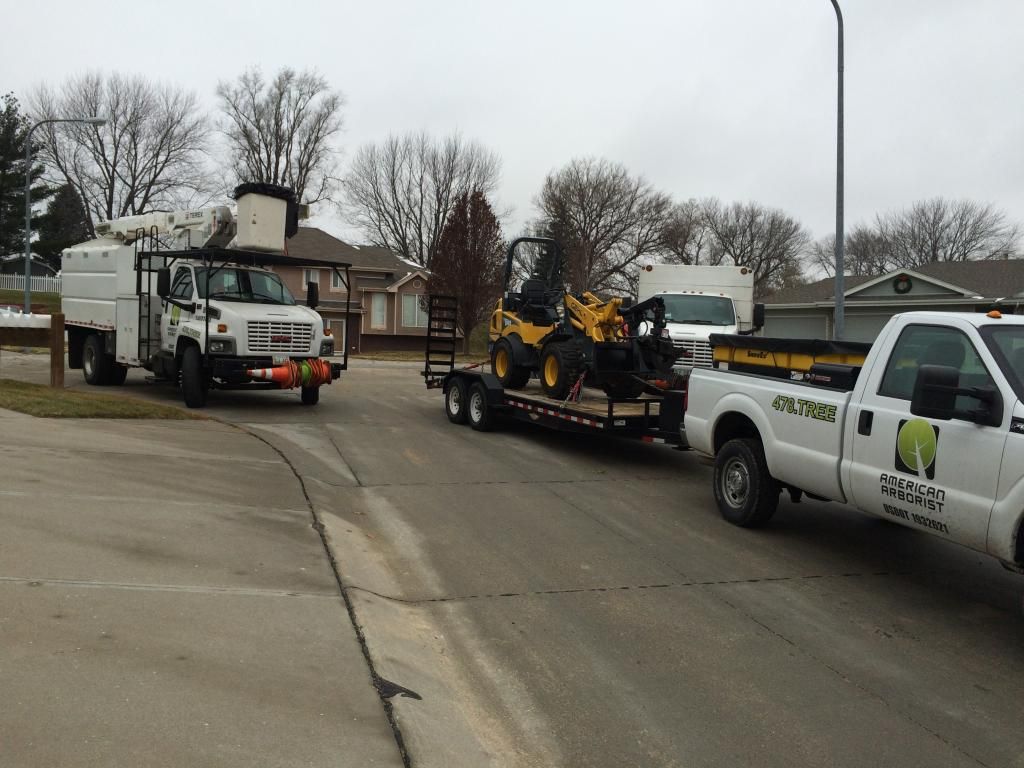

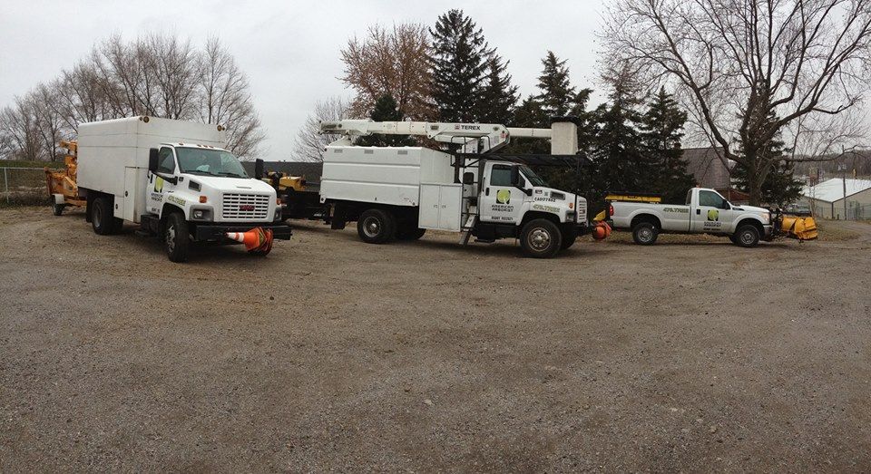

For me, not going CDL is a calculated risk. All my trucks are under 26,000 and all my trailers and chippers are under 10,000. This allows me to operate without the headache of CDL drivers and DOT. When my trucks are fully loaded or a trailer full of logs, the axles are sufficiently strong enough to handle the load but on paper I am over weight. This is because they are de rated. Why do I do it this way? Because we have a relatively low DOT presence within the town I work in. We travel only 15 or so miles in any direction. Most of our travel time we are within compliance. The few times we are over I do risk getting over weight tickets. I've never had an over weight ticket and to me the cost of getting a ticket for being over weight is much better than all the headaches and costs that come along with DOT operations.
Example, this truck is safe to operate, but illegal on paper.
The key to not getting pulled over in Omaha is to have good looking newer trucks.
If I have to move my Gehl Loader around, it gets pulled by the pickup as the trailer is rated 14k.
Not saying this method of operating is for everyone, but for me it makes sense.

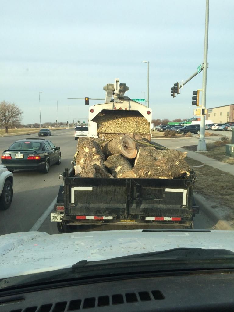

Here, you'd most likely get ticketed for an unsecured load on your dump trailer.
Load securement is huge here right now. I heard a story of a guy that didn't fully clean out chips from his dump trailer. Some chips were left in the corner and the DOT wrote him up for unsecured load. I've also heard stories of cargo trailers, even though they are enclosed, if something wasn't strapped down properly you'd get a ticket for unsecured load. And now just last week I heard of unsecured load inside the cab of the truck, stuff sitting up on the dash and what not. You have to understand something, it's all about the money right now, the governments are broke and need the coin.
that actually brings up a good point. the back of the chip truck isn't enclosed and can be cited as an unsecured load.
