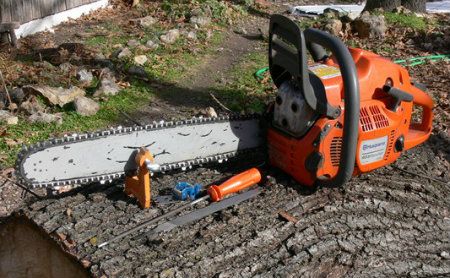

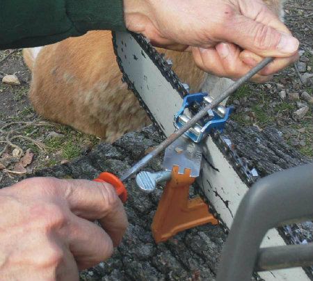

Words to live by... "never sharpen a dull chain. Put a razor edge on a sharp chain." It does take only a few minutes, and actually gets your chain through more wood before it needs to be replaced. Also puts less wear on your bar, and less fatigue on the user. Also safer, since you have more control over it. I'm an absolute believer in stump vises, and use the Husqvarna sharpening guide every three or four sharpenings. Whether you sharpen it hot or cold, tension the chain first, so it doesn't wobble on you. And pay attention to the rakers. If a sharp chain doesn't cut right, take a flat file to the rakers, and use a guide to bring them down (typically every three or four sharpenings).
Over tensioning your chain to sharpen it is unnecessary if you have a plastic felling wedge to stuff between bar and chain intermittently.
