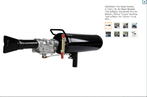

DIY APTA using bazooka style bead blaster
This one is only $72 on Amazon. If that barrel will unscrew it would be perfect for an APTA. I like the trigger idea instead of lever ball or butterfly valve. For $50, I made mine of 1.5 inch PVC and a 3/4 NPT brass ball valve. It works okay for me but a trigger would be an improvement.

We've used ether in a pinch to seat beads, but it isn't always a realistic option, (and it ALWAYS scares the piss outta me). One of my 3 vans is a big P30 Step van and since I got a flat, I decided I needed a bead blaster. Wish I'd have bought the bazooka style to begin with, but if nothing else, I've got another reserve tank if I end up now getting the bazooka style.

They say that the stubby pressure tank delivers the air more all-at-once, maintaining greater consistency in this calculation. That is it's big selling point over the less expensive APTA.
With a little practice, the butterfly valve in the APTA works very well at dumping all the air fast. I set the throw bag tight against the valve with a short wooden pole. One foot of height per one psi is a close approximate.

Sure, it releases all of the air at once because there isn't very much air. Having more air wouldn't help if it isn't all released at once. To release more, you'd need a bigger valve. They made a decision to keep a reasonable size valve for (I'd assume) cost and portability.
Here is my big game rifle. Coming in around 7 ft long I can consistently hit crotches well over 150 foot. Because of its length you shoot it like a mortar so the accuracy is much better than the over the shoulder style of my APTA from TS. The silky smooth valve also adds to its accuracy.
