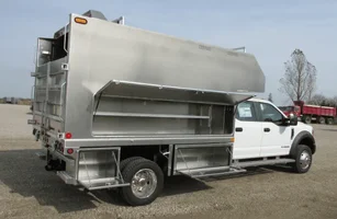

What about bolting boxes to the outside of a box as pictured above?

Hmm, saw a dump for sale which had that basic setup with aluminum boxes along the sides. Are you thinking a diy like that or a custom job like the canadian below that would be more rugged for loading wood? 1551876687412-779533851.webpThe whole putting another box inside of a steel dump body seems cost effective but not gvw effective. What's your payload capacity @DTS ?
Custom either way for me. I have an email into that Canadian company to see if I could swing that type of box in aluminum. Otherwise it will be a steel box with 18 x18 slots along the bottom of each side to mount toolboxes in. (A hooklift bed I can just set on the ground when not in use.)
