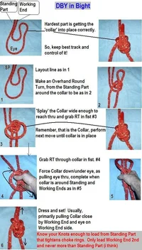

Knudeone/Dan Ledham snail-mailed me pages and pages of these fantastic, meticuloulsy, hand penned drawings of different dated and numbered knots he has been working on the design of.
We've tossed a few things back and forth; and using his strategies, have altered one form into a Double Bowline with Yosemite tie off, tied in the bight of the line. More of a curiosity compared to what he has got though!
