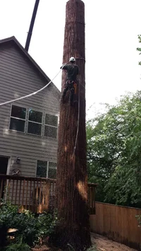

Thanks for the replies. Here's a picture of the scene I am describing. We wanted to put the porty on a far tree to control the drift, but had to handline the tag.
I am using the Redwood (Coastal) for board and bat siding on a cabin, so we needed longer pieces to mill (14+') and heavier weights.
So, what I am getting is that this is very a subjective call by the crane operator on the use of the porty to control drift, no rules or regs in regards to this. Is that right?

That deflection--elasticity in the steel of the crane--upon release of the last piece (the butt log) had 3 guys hauling on the tagline for all they were worth to prevent the piece from drifting into the deck on the bounce. Luckily no damage, but I sure would have preferred to have it on the porty and I will try to reason with the crane operator a little more about it if we do it again. In most of these lower butt log arrangements, it is not going to cause the piece to pull over the crane, although I could see how problems might arise where the load of the piece is reaching the load limit of the chart on the crane. I hope this bit of discussion helped illuminate an area of work not often considered.
We've used a porty several times to control the swing, and the crane ops have always been cool with it. They don't want to bingo the house/shed/window any more than we do. Never took much explaining to get them on board either "We'll take some wraps to stop the swing, cut it, pay out the rope until she's completely hanging from you, take the rope off the porty and you fly it away." "Sounds good!"
Looks like that tag line will easily slide off the piece once airborn and it inevitably gets a little slack.
True, Vet. Here we are just holding the line out as a small face is being cut. We snugged it up at the end for the release, and it worked. I guess we could've used a clove hitch which might have been better--what do you use for a tagline knot on pieces?
