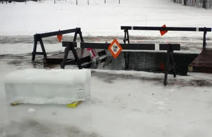

Be sure to take pictures of this whole operation!
Looks fun and it looks like it turned out good. That's my sauna in my avatar, it sits on the rocks and one step out the door and your in 20 feet of water. My polar bear days are over though.
