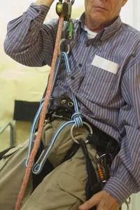

I modified a Cougar using Matt Cornell's Ideas.
The Hip rings are 64mm ID Pensafe, the Bridge Ring is 46mm ID CTS, the Bridge is 16 Strand 1/2" Arbomaster Bluestreak.
I used larger hip rings so the buckles would fit thru.
