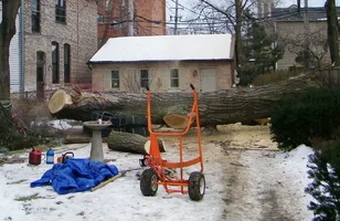

These are 6 truck tires 'tied' together on top of 3 or 4 sheets of 3/4" plywood.
44" Eastern cottonwood at touchdown. The tire and plywood combo have worked like a charm.
