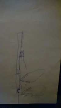

I'd put simple fairleads on the lower portion of the base.
I'd put a tie-off cleat on it.
You could combine the fairleads with a tie-off cleat.
Maybe a sloping cut would load the crane with less peak force?????

Good develop.... for the cut i'll do the classic cut that use every time when fall with a crane..... so the piece don't move and move only a little when you lift it. For the bollard on the pole don't is possible otherwise the pole can't slide down into its casing when you must move all for the next piece..... when i found a best video i'll post immedialtly so you can see how do for the next step after you have cut the first portion of trunk....

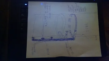

Here i post some other pictures that i've take when the guy presented the T RED SPIDER... so you can see better and understand better the tool......
I think the big fault is the second strap.... with only one ancor point the pole bend every time.... with 2 the pole i think will be a lot of more stable..... Like said from Southsoundtree
Looks like the red "arms" should be higher and lower, with 2 ratchet straps.
In the last pictures you can see better the casing-engages of the pole.... when you assemble you put the pole throught the casing from down to up and engage it in its joint.... when you must re-set all disengage the pole from his joint and lower it and leave it stand on its casing... i hope is little more clear
