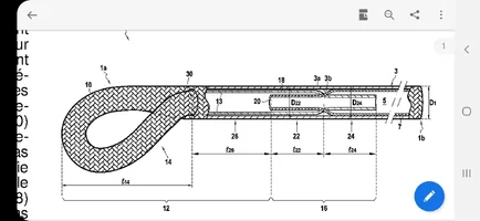

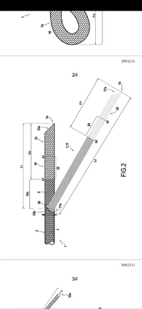

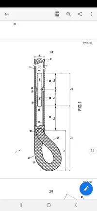

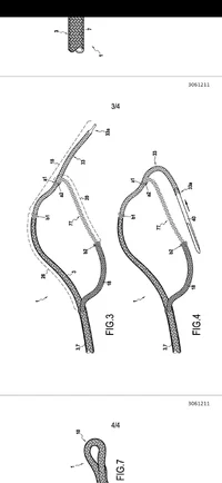

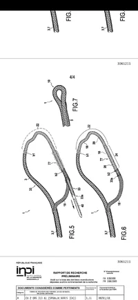

Found the patent.
Screenshot_20191021-211418_Adobe Acrobat.webpScreenshot_20191021-211442_Adobe Acrobat.webpScreenshot_20191021-211434_Adobe Acrobat.webpScreenshot_20191021-211451_Adobe Acrobat.webpScreenshot_20191021-211445_Adobe Acrobat.webp
Found the patent.
View attachment 63027View attachment 63028View attachment 63029View attachment 63030View attachment 63031

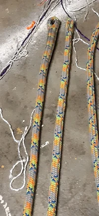

I just got a short chunk with the splice to dissect. I found five whipping twine ends, the first thread and the three through six threads from the throat. The second thread looks like it goes over a cover strand on purpose and might exit at the first thread, as it is directly across from it. Each of the ends happened at a reduction in diameter.
The diameter is the same from the sixth thread exit, until at eleven inches from the throat, where it reduces slightly, and continues to do so at intervals, for I think eight feet.E9E1A086-B309-45BE-8387-5A16D7BF3BD3.jpeg
Definitely whipping twine, they sent a sample by tying a tag on the rope with it.
ok, so, running through the patent i have the following draft instructions, these will be in metric.
mark 200mm from end
Mark 400mm from end
Mark 600mm from end (between this and last mark is un reduced internal component and will extend to 300mm with core removed.)
measure length of eye desired from 650mm mark (75mm~3" works well)
extract core at the end of the eye measurement
milk rope till no movement
mark on core where exits from jacket
pull core from jacket
mark 300mm on core from exit mark further down the rope
mark 500mm on core from exit mark further down the rope
mark on core 700mm from the exit mark further down the rope
from this point remove 50% of core fibers
from second mark on jacket (2nd closest to end of rope) remove 50% of fibers
crossover these reduced sections of core and jacket at the 200mm marks made pulling the ends out at the point of reduction
milk assembly and ensure 200mm marks align (first mark on reduced section from reduction point)
trim remaining ends protruding from crossover burry and milk to set these inside the core/sheath, these ends should meet the points where the reduction of fibers was done smoothly when under load or extend slightly with a taper to the point where the reduction was done to prevent noticeable bumps at these point.
while holding crossover to prevent movement millk rope to pull assembly into sheath
zig zag hidden whip 150mm from the eye down the rope
Note for reduction points and ends i of burried lengths, tapering over a couple of inches gives the best results
Please add to, adjust, make suggestions etc for these instructions. the burry lengths are directly from the patent and should be made no shorter

This is a nice and easy splice once it’s sorted out. My reducing of the cover and core were sloppy, but this half inch Stable Braid still turned out.
