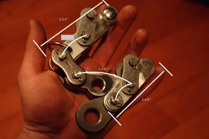

John has one of the new Bones with the shorter pivot length (1-3/8")
Treevet will receive one of the new bones with the 1/2" bollard for Vortex.

Gordon could answer that better than I can, but it is shorter than the previous version. Not sure if that means it is compatible with Vortex though...
Exactly, I went and measured it!

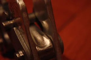

the new bones have a small groove in the spine to allow for better slack tending (and ascending) with a fatter rope.

If you look at my post back on page 90 I have a photo of the spine contour.
Or I guess I could just repost it here...
